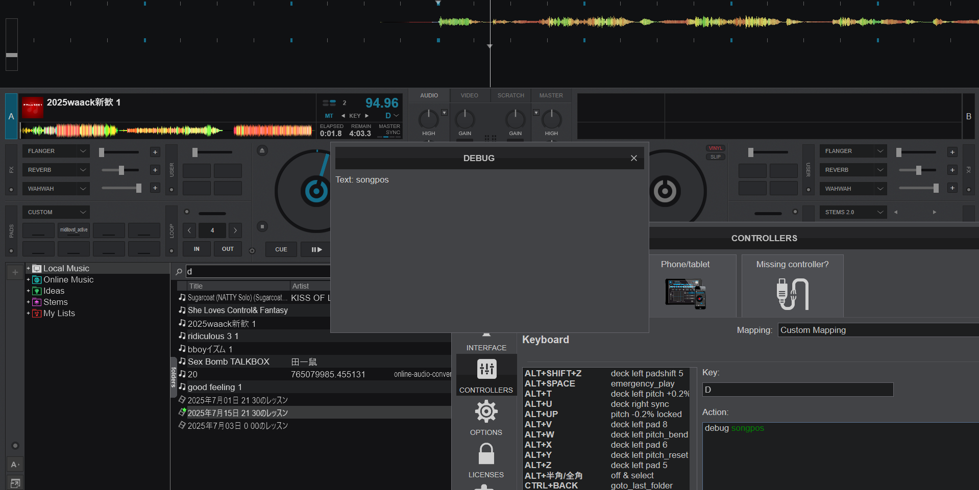

I tried debug songpos to check the current position in VirtualDJ, but it only shows a window with the word "songpos."
Is there a way to show the actual value?
Posted Tue 22 Jul 25 @ 6:05 am
For a start it's song_pos not songpos.
And the syntax for debug is
GetThing & param_cast & debug

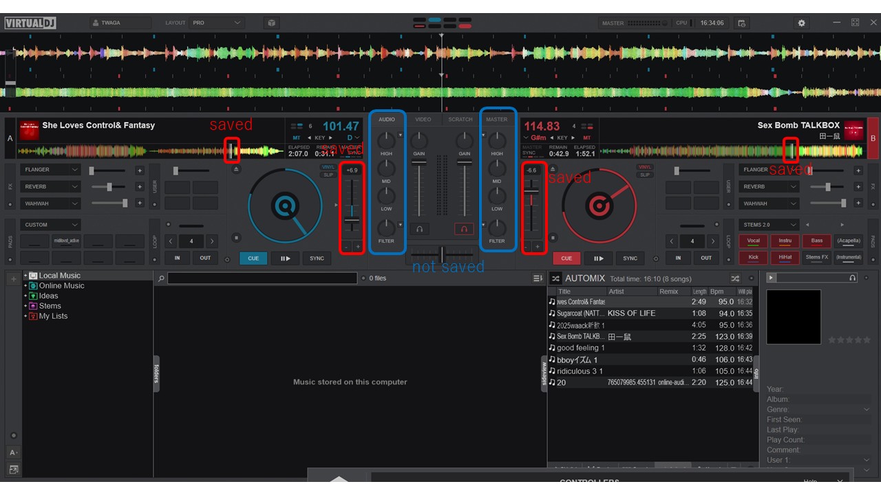

For the past few years, I've been creating long DJ mixes—sometimes lasting up to 10 hours—over the course of several days. When I stop for the day, I pause the mix and take a picture of my screen with my phone so I can remember the exact playback position and settings. The next day, I manually restore the decks to the same position and settings based on the photo. After finishing the full mix, I use video editing software to cut out any silent parts between sessions.
Ideally, I’d like to develop a plugin (or request a feature) that lets me save the current session state—including the playhead position, pitch, and EQ values of both decks—and then resume exactly where I left off the next day.
Ultimately, I’d like to develop a plugin that has this kind of functionality.
Posted Tue 22 Jul 25 @ 7:16 am
Perhaps you can experiment with save_deck_set and load_deck_set then.
Also, you could set a "temporary" hotcue (let's say hotcue 99) on the position that you want to keep in memory, that you can delete afterwards (after you resume your working with the mix the next day)
So, instead of trying to seek to position 48.87% on the song (that would be what song_pos reports) you have a hotcue ready to take you there. And hotcues are virtually unlimited in VitualDJ. Therefore you don't have to "waste" a "good" slot (hotcues 1-8). You can decide to always use hotcue 99, or hotcue 20 or whatever number you want..

Thanks for your opinion and very helpful information!
I was able to save the pitch value and the pause point with save_the_deck. I'm satisfied with just that, but it couldn't save the EQ value. It would be great if the EQ value could also be saved.

The xml file saved by save_deck_set looks like this:
<deckset version="850" date="2025/07/22">
<load deck="1" filepath="xxx.wav" volume="4096" pos="5985252" gain="2048" pitch="4377"/>
<load deck="2" filepath="yyy.mp3" volume="4096" pos="4616170" gain="2048" pitch="3824"/>
</deckset>
I wonder if it is possible to specify high, mid, and low attributes in the load tag by editting this xml file manually.
Posted Tue 22 Jul 25 @ 1:57 pm
Probably not, as part of your save deck set procedure you could write a script to an unused tag and recall it next time round.
Posted Tue 22 Jul 25 @ 2:34 pm
I tried various attribute names such as high, eq_high, eq_high_freq, but I couldn't specify equalizer values. It's strange that we can't specify equalizer values even though there is GAIN attribute.
Posted Tue 22 Jul 25 @ 11:48 pm
